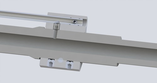

Finding a barrel with a properly sized gas port for dedicated suppressed use will be difficult.
As stated before, it will generally need to be made using a cut down barrel.
As an easy alternative, we offer the MicroTune gas block, which accomplishes gas regulation at the proper location just above the existing gas port in the barrel.
This allows you to select the size to achieve the proper level of gas drive for nearly any application, including a dedicated suppressed SBR.
Its almost as good as a dedicated suppressed barrel and works on the barrel of your choice.
