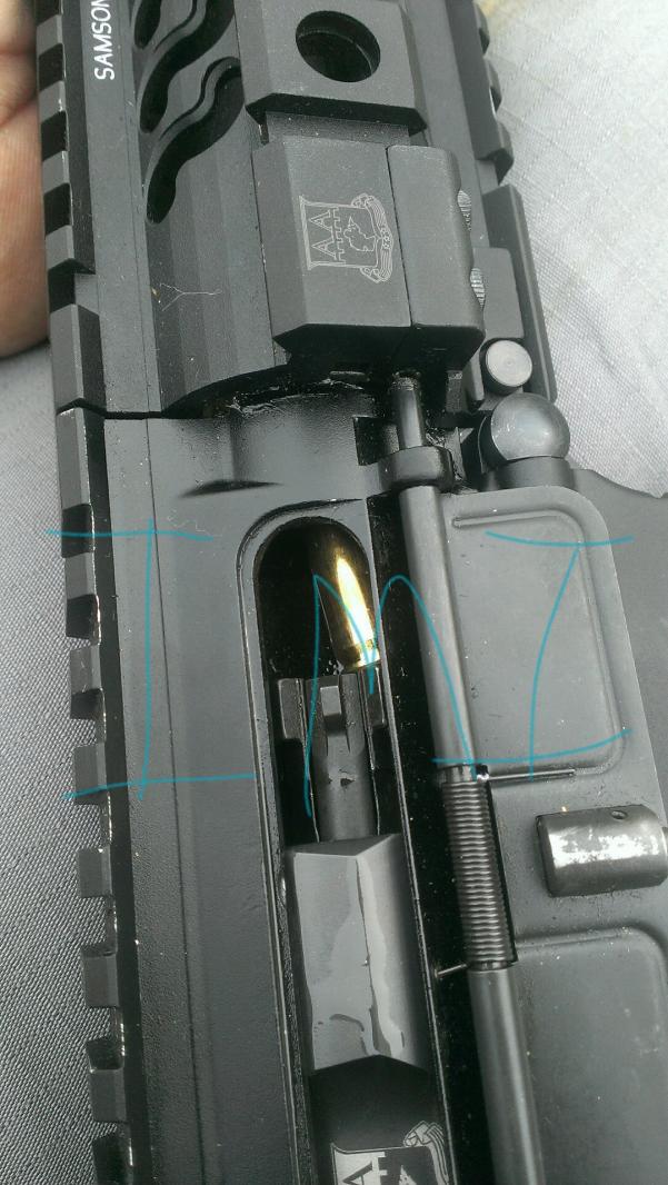

Hey all. I’ve always been a lurker more than a poster because I learn way more on here than I could ever share, but I need some help. I’ve had my complete Adams Arms 16" tactical elite rifle for over a year. I’ve shot probably about 1000 rounds through it with no issues until last weekend. Larry Vickers hardly makes it to Iowa so of course, my rifle started to fail to chamber completely. It ran fine every time I shot it before that. I cleaned it prior to the class and it was well lubed. I’ve emailed AA twice this last week with no response. And no, I don’t need to hear about piston vs. di. I’m already ordering a BCM upper this week. This is what it started doing:

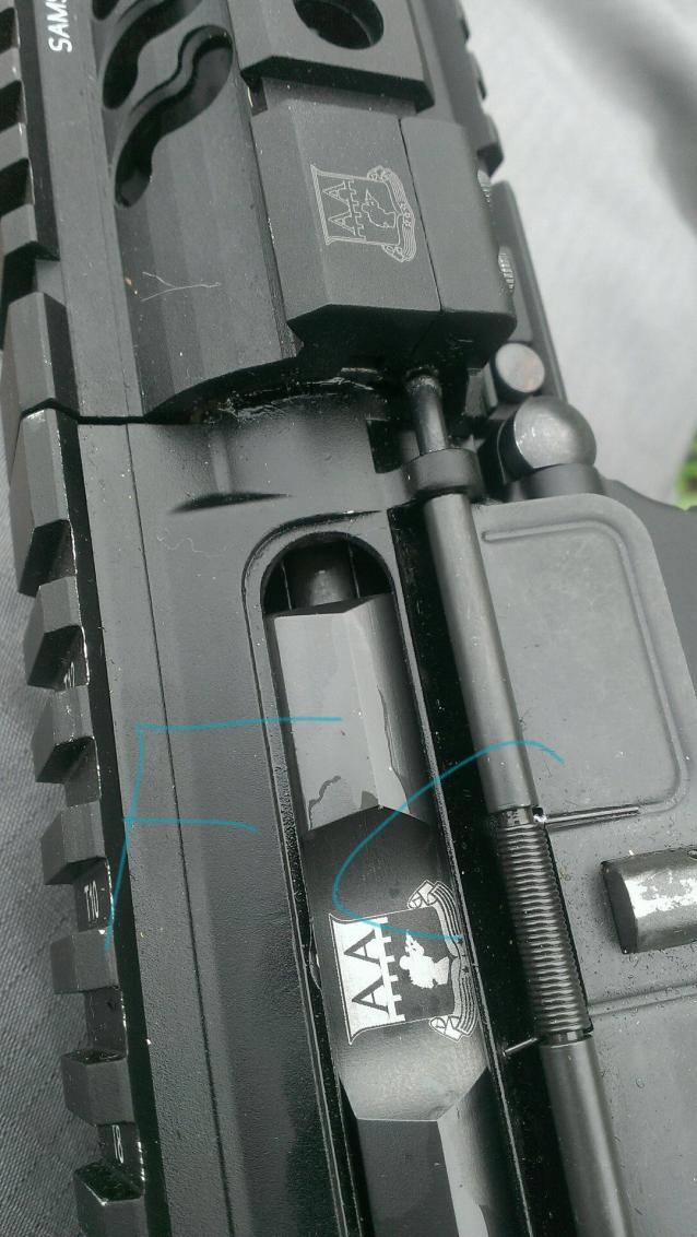

Ammo was IMI/Samson 5.56 55 grain new, no reloads. This was out of a new PMag, but I had the same issues out of a new brownells mag, an old g1 pmag with different ammo, and another 20 round pmag with different ammo (not sure of the brand since people loaned me mags to try). Upon advice to change the extractor spring, I upgraded it to a BCM kit, still no luck. I have a 14.5" AA tac elite rifle also, runs great, no issues with this ammo, mags, or anything. I swapped bolt carrier’s, same issues in the 16" with a different bolt carrier. This was not the first round, but after a few rounds fired, so it wasn’t after bolt lock. It did again to me today with IMI ammo and Federal 5.56 ammo out of any kind of mag I have. Locking the bolt back and loading a mag then hitting the paddle resulted in this today:
When this happened it was almost impossible to pull the charging handle back to clear it. I don’t know what is going on. Sorry, I know I probably need to provide more info, but I’ve got mad twin boys who are trying to hi-jack my computer!!

I think IG is onto it with asking about buffer spring and lugs. I say this because in your first picture if your buffer spring was strong it should override your bolt spring (bolt pushed back into carrier) with it as far forward as it is. Unless of course your bolt or extension lugs are jacked.

One thing I have noticed is that the AA uppers are not radius-ed in the 2 M4 feed ramps and barrel extension. I have done this with a few uppers to eliminate marking the brass (putting scratches on neck of case). After slight removal of the sharp edges, the feed seems a bit smoother (by hand, dummy non-loaded ammo) and no marking on the spent case. I don’t think this IS your issue, but may contribute (picture 1 has the cartridge just entering the chamber at the ogive…there a bouts and is past that issue as a factor).
