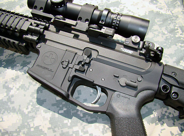

For me, the choice was an easy one, as I’ve been seriously considering a 6.8 SPC project for at least the past two or three years. Proving that good things do come to those who wait, after months of planning, research, coordination and gathering various parts, I am happy to report that the result finally cleared my workbench as of a few days ago. While, as a rule, I tend not to provide too many insights into the contents of my gun cabinet, I will be making an exception for this rifle because I feel compelled to draw attention to some of the more noteworthy components that have gone into building it.
Specifics will doubtless be highlighted in future posts, but by way of introduction, the “Summer of 6.8” project will see me putting a new caliber through its paces (6.8 SPC), evaluating some of the accessories unique to the new round (PRI magazines, etc.), pressing a new trigger into service (Wilson Combat TTU), wringing out a new mid-gas match upper (Rainier Arms UltraMatch Elite 16) and testing several other components which will be heading to the range with me for the very first time. It’s been a long road to this point, but as you have likely surmised by now, I have carefully avoided taking any shortcuts.

If the weapon in that photo is your actual build, the Gods have defiantly smiled upon you with that lower! Outstanding acquisition!
I can confirm that much.
As I said, this project had been in the planning stages for a long, long time, and part of the larger strategy included the acquisition of an MPLA. Not that such a thing is easy, but I had time (and timing) on my side.
