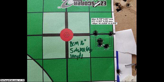

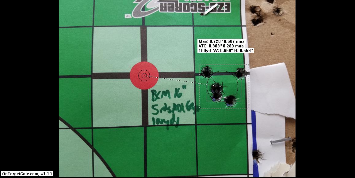

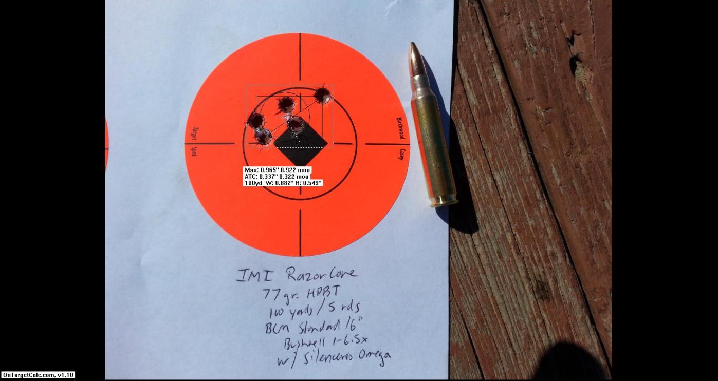

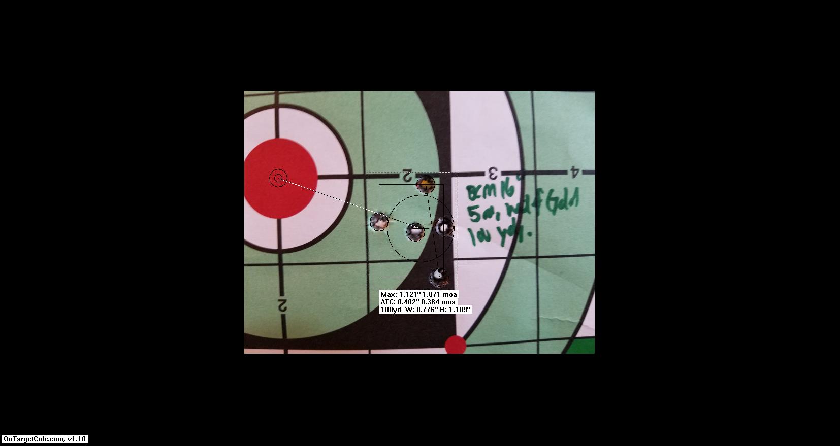

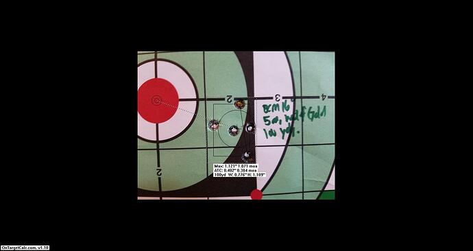

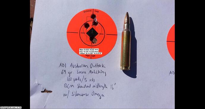

I have a BCM standard 16" mid that has really surprised me. I plan on keeping it. A mix of Australian Outback 69 gr. Smk, IMI 77gr. Razor core and if I read my handwriting correctly…wolf gold. :confused: Shot through a Sico omega and a sico specwar 556k.
Here’s some of my BCM barrel accuracy results, the upper is BCM with one of their “Standard” 16-inch government profile mid-length barrels, non-free floated with a standard FSB. Gun is topped with a Steiner P4xi.
Here’s the best groups from a shooting session with IMI 77gr.
I’ve gotten groups as small as .97" with this gun but they aren’t the norm. 1.5 - 2" is more typical with this ammo. However that seems pretty decent to me considering the configuration of the gun in question.
