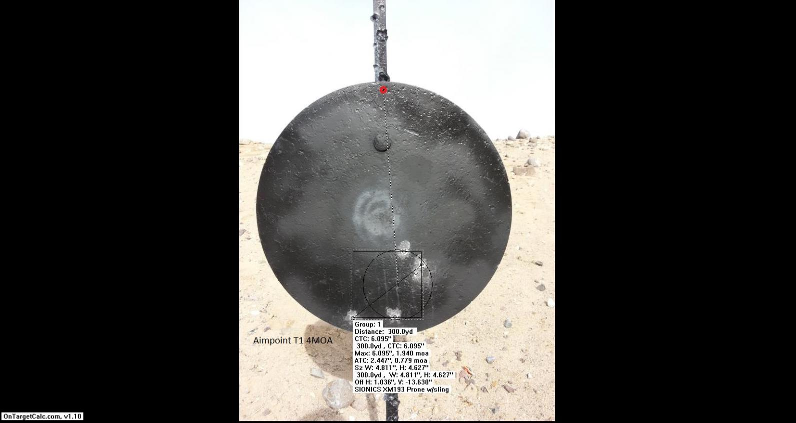

I’m no highpower/benchrest shooter and/or competitor. Most of my shot groups for score are from the prone position with bulk factory ammo, and am pleased with the performance. I have produced these, and more like them at 300yds with a Patrol Zero upper, DD Omega 9.0, Aimpoint T1 4MOA, sling, and bulk factory ammo:
Walmart ZQI 62gr:
Walmart ZQI 62gr:
Typical XM193:
Again, those are from a chrome bore, and me behind the rifle. Other shooters will do better.
