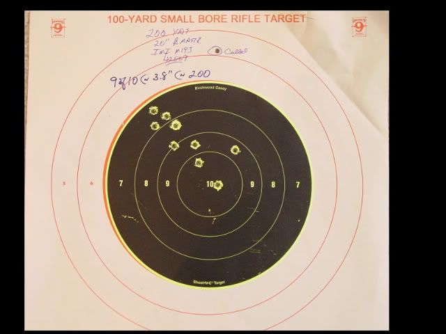

IMI M193 worked well for me to 300M when I was shooting 3-Gun (a long time ago). I put quite a bit of it on freshly painted gongs at 300M and was happy. A 1x9 NATO chamber Dissipator would group surprisingly well with it at that distance. Past 300 it fell apart pretty quickly. I bought a case of the 2009 IMI recently and compared it to some '99 TZZ I have -it seems to be the same.
I have not worked with the mouse guns in 10 years, but managed to put 9 of 10 in 2.0" at 100 Yds and 9 of 10 in 3.8" at 200 Yds. Upper was a 1x9 Bushy 20" with an old TA01NSN ACOG. I made do with an improvised rest (forgot my rifle rest) and no butt-bag. Targets were 8" black bulls, which suck with a 4X scope since I could not see the black stadia lines over the black target.
I’ll find out how it works in a 1x7 soon enough. Buying that one case of ammo resulted in ordering a new Mid Length upper to go with it.
