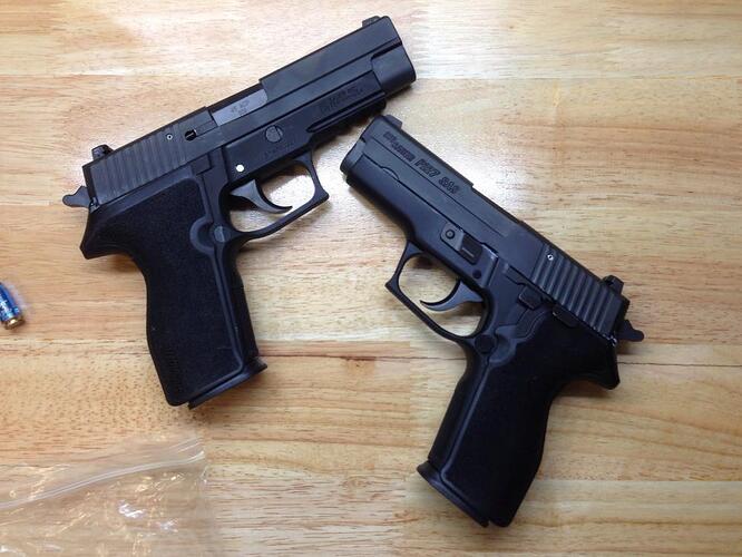

A Pair of Sig P227's and Then Some
Notice the triggers…
Both have the factory SRT kits and Bruce Gray’s Precision Intermediate Trigger. This is the best combination of DA trigger pull, reset, and ZERO over travel of any DA/SA pistol that I have experienced. It is hands down better than any HK, FN, S&W, or Beretta (yes, even with a D spring) that I own. Granted, this is only dry fire since I just completed the install, but it is one helluva start. The cost of these modifications (minus labor) is $50-100 depending on if your SRT came from the factory.
The P227 has about 300 trouble free rounds and the SAS has only 200 prior to installation of the triggers to check basic function. So, the jury is still out in terms of reliability or durability. Accuracy is on par for what I have come to expect from Sig as I was able to keep a full magazine of 230 grain AE in the - 0 box on an IDPA target at 25 yards.
I hope to put another 100-150 round through both over the next couple of weeks including a couple of boxes of 230 grain Gold Dot which is my carry ammo. I’ll try to work in some FAST drills and Dot Torture and report back.
