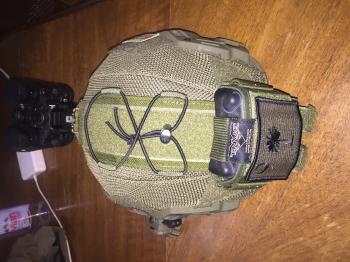

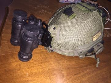

The first thing you notice is how light they are. It really does feel pretty much like just a 14 on your head. I run a BAE OASYS UTMx as my scanning thermal coyote and hog hunting and being able to rotate one monocular up and scan with the thermal while also using the NOD is just plain awesome. I know the politics, but to me the TW helmet has always been the most comfortable, so I checked my ethics at the door and got an Exfil. Also got a TNVC Mohawk for the battery pack. Thusfar I have not even used the battery pack, just have been running the single onboard battery.
Turning the unit on is a bit different than any of the other units I have used. The power button is the gain button and you just press it for a second or two and the unit comes on. It has pivot positional stops so once you get the correct spacing on the eyepieces, you screw those stops in and if you pivot the unit up and back down it stops right where you left it. The diopter adjustment is a clip on lens vs the dialing type on the 14. It comes wih a -0.5 I believe (which is the most common according to science and stuff:) but you can get replacements.
