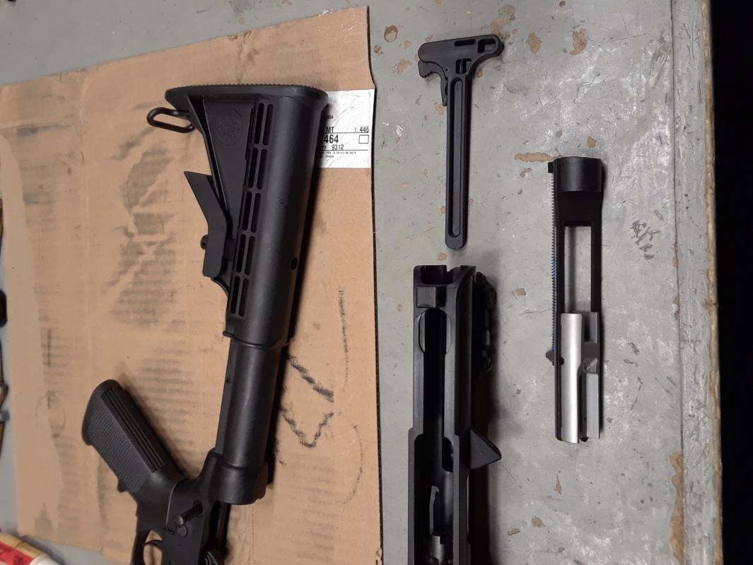

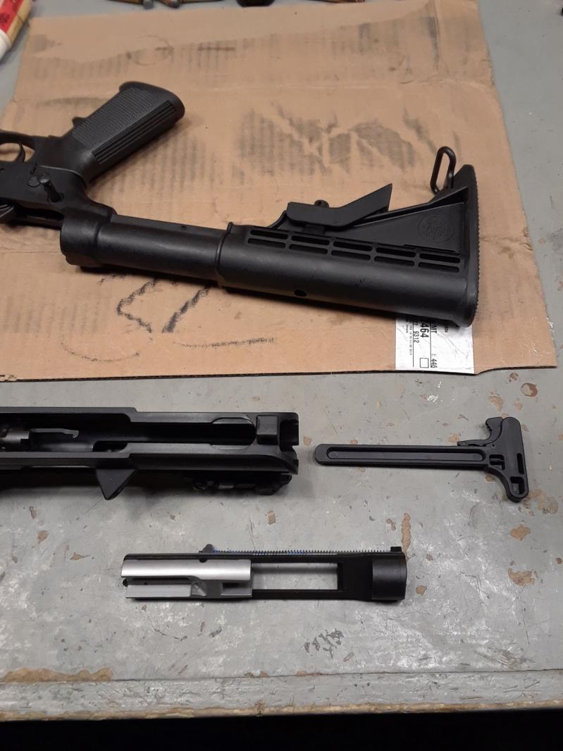

A look inside my brand-new Smith 15-22
Y’all are right about empty posts concerning newly purchased guns. So here’s a post with content that might interest some viewers.
This gun is not a cosmetic phony. All controls work just as they would on an AR-15.
So I field stripped it. It comes apart just like a real AR. You remove the captured pins, and the (polymer) upper separates from the (polymer) lower.
The bolt carrier comes out along with the charging handle, just like the real thing.

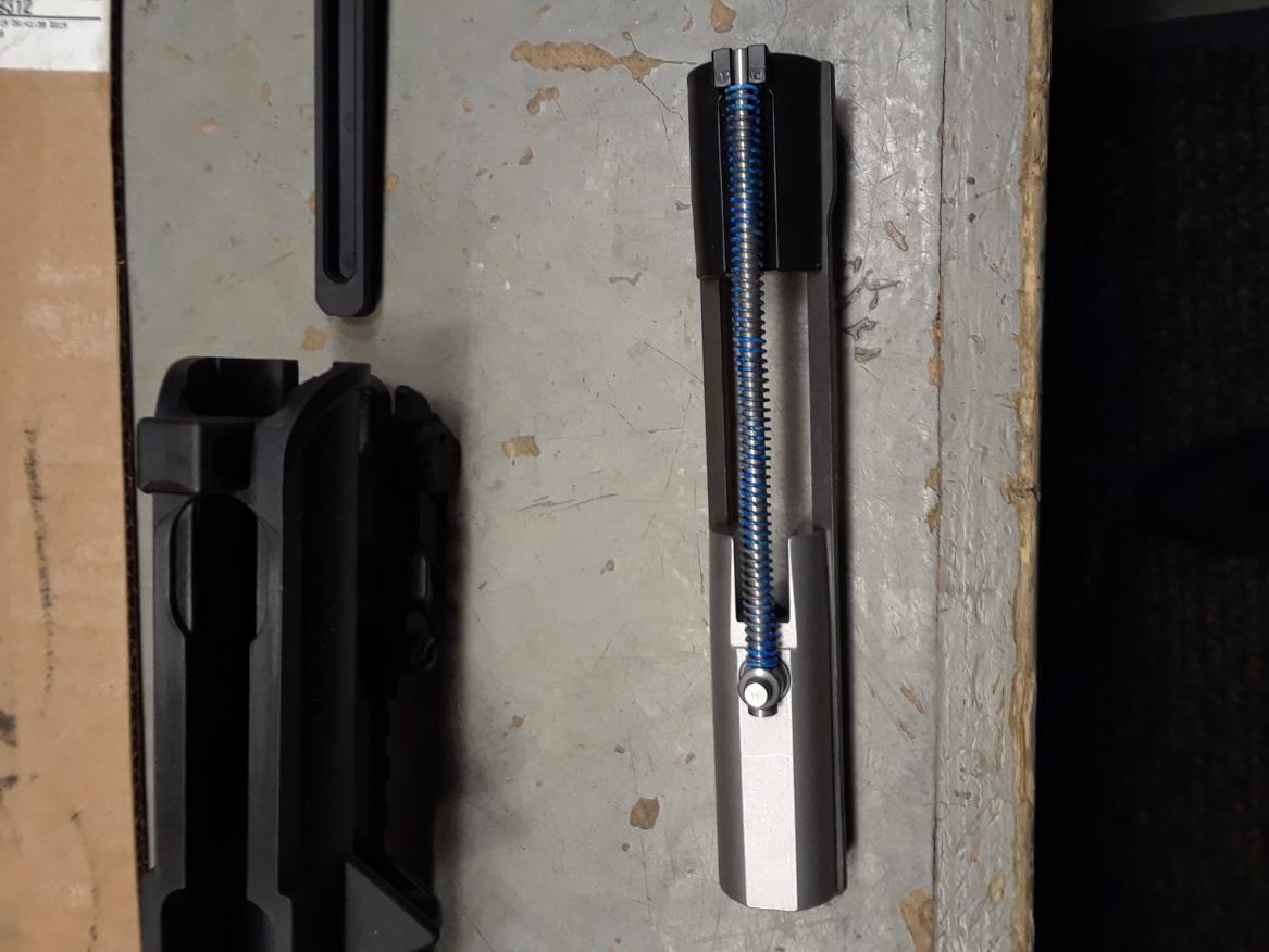

The bolt does not reciprocate into the buffer tube like an AR’s does; indeed there is no buffer tube in the stock. Instead, the bolt rides on two rails and compresses the return spring which is mounted on a guide rod.
The bore can be cleaned from the chamber end (unlike the 10/22).

Those are good pics of the disassembly. Very similar to an AR and super easy to clean. Fire control looks like you could replace with any AR trigger group. Mine has Magpul flip up sights. It has a QD sling point at the rear so perfect for a single point sling.
