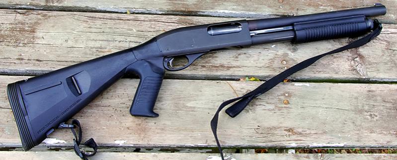

I have tested nearly every stock, stock adapter, folding stock, collapsible stock, recoil-absorbing stock and stock accessory on the market. Recently, one of our bigger agencies (5000+) was looking at AR stock adapters so the shotguns could fit in the same mount as their carbines. (The Chief wouldn’t spring for new vehicle mounts and not every officer was carbine-qualified.) I tested nearly everything and hated them all. There were very few I would trust with my life. I concluded that one cannot turn a shotgun into an AR by adding a collapsible stock and watching a few Chris Costa videos.
The one I recommended, and possibly the BEST stock that would fit your needs exactly (in my personal opinion … which is worth something north of about 1.67 cents) is the Mesa Urbino stock. I have found through much testing that tall shooters can shoot short stocks, but short shooters will struggle with long stocks. (This is why I feel that shotguns are often both poorly trained and under appreciated in police academies these days.)
The overall length of a shotgun with a fixed Urbino stock is only an inch or two longer than a completely collapsed AR stock with adapter, and is MUCH more comfortable to shoot. To me, it is the best combination between maximum portability and minimum fuss if you need it in a hurry.
