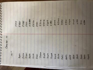

Left column is 16” BCM mid length barrel. Right column is BCM 11.5” ELW barrel.
Just HAD to put it sideways, didn’t ya! Was that 2600-ish fps from the 16" barrel? If so that really isn’t too bad for a .223 powered heavy-for-caliber load. I have the 64gr Gold Dots and they are not “weak” as compared to my 5.56NATO rounds. I surmise that while the Gold Dot AR loads are technically .223 and not 5.56NATO, they are stout for .223 ammo.
It was vertical on my iPad and then it posted sideways. I dunno.
But year. 2600 frombthr 16”. It was a little warm and the ammo might have been in the sun a bit before shooting. I was getting 3400 FPS on the BH 50 TSX. The 70gr GMX BH load was stupid hot. 2950ish from the 16”. And you could feel it. One of the few rounds I’ve ever noticed a real difference in recoil.

Those 16" velocities look at little high to me, like def not 223 pressure high.
Not going to argue. Heat soak could have been a factor.
