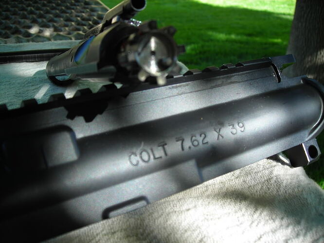

I would also choose a 300 BO as the magazine issue is the center of the “problems” with a 7.62 x 39 AR. No problems with the kit pictured, Colt 5 shot magazines and a working C products 25 round. Old metal 20 round GI mags normally run up to 7 rounds flawlessly.
