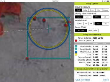

Shot this group Saturday at 1000yds man do I wish they all looked like that.

DPMS upper, lower and BCG Geissle high speed national match trigger 26” bull Krieger

That is some pretty good shooting, what kind of wind and what bullet weight?

If you could improve the consistency a bit, you may be able to embarrass a few bolt action guys on a good day. I find it amazing that a semi auto platform can achieve sub-MOA at 1k, but it can be done.
7 mph 140gr eld-m I had a 30” target at 1200yds we where ringing pretty well that day also my shooting buddy brought his 338 lapua that thing is almost like cheating at those ranges he also brought his 308 AR-10 that day he struggles much more with that gun I really enjoy my 6.5 AR-10 but my next gun will be a bolt gun possibly a 338

Nice shooting! What is the software program you’re using to measure/analyze your groups?

It’s part of the Bullseye target camera software
