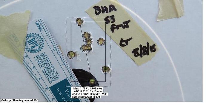

Here’s a 10rd group with BHA 55 FMJ reman, ~1.7" from my LT Stealth. I’ve shot some more of this from the same gun to 600yds and it stayed on 12x20 steel without a problem. It’s running out of gas at that distance, but it should stay on smaller plates and/or stretch a little farther.
Reman 55 JSP did about as well but I don’t recall the details. Also consider trying the 60 V-Max and 68 OTM, both of which are available in reman as well. These options will be more expensive than bulk .223, but you’ll get a lot more out of them than many others.

Ok, so the 1.5 MOA group you mention above was a 10rd group?
