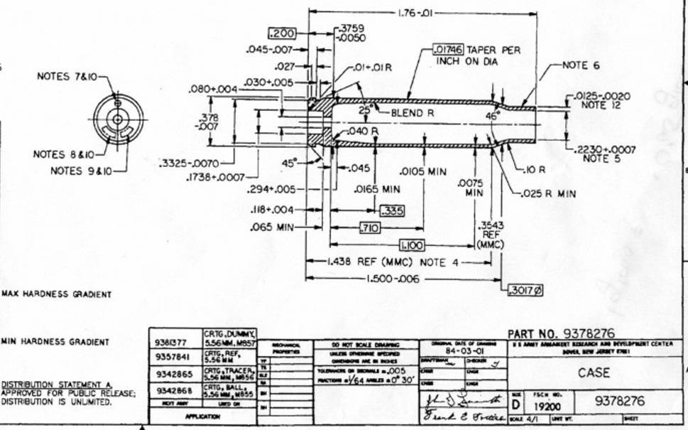

GI mil-standard is .080 ~ +.004
Thanks, guys, esp sinister, and yes, I too doubt FH dia makes any diff for AR accuracy, but it’s the easiest part of working brass (for a bored old man). I was drilling 080 and ignoring the loose holes. And now I may start using my old Sinclair fh deburring tool since 082 seems to be within reason. And the only reason I uniform pocket depth is in hopes of reducing shallow pockets interacting with civvy primers and floating firing pins… I waste a lot of time in reloading so I can blame poor performance strictly on myself for not having my eyes closed or on not pulling the trigger hard enough…
Sinister for the win! That makes sense based on the readings I was taking and that LaPua was right on the money.
