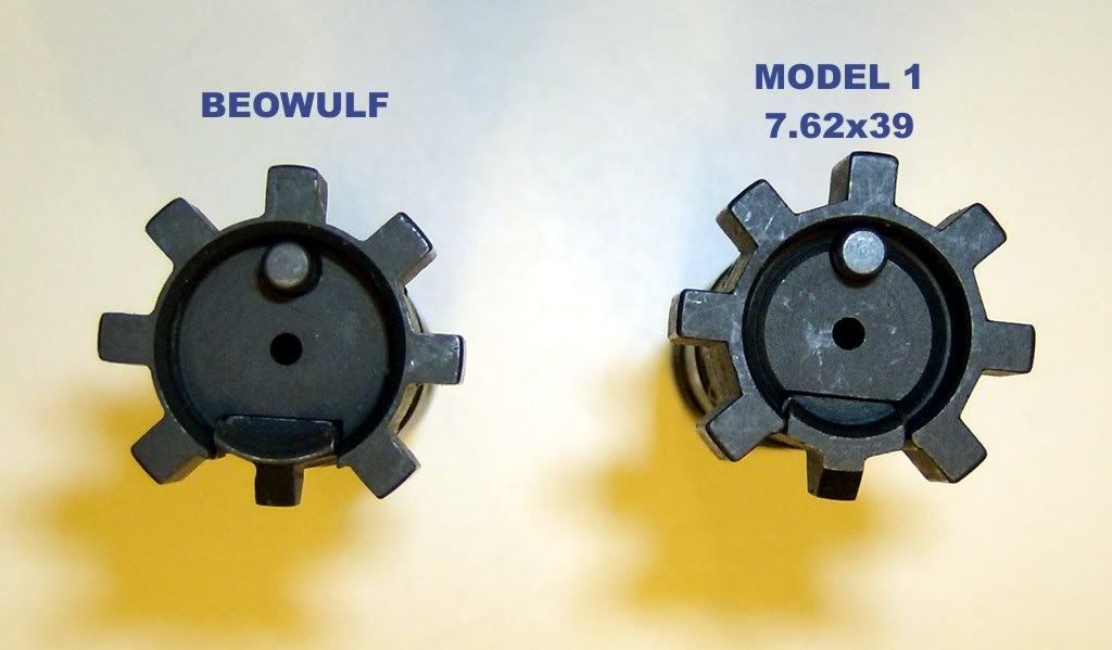

Even though the bases of the 7.62x39 and Beowulf cartridges are the same diameter:
The bolts are not the same:
Don’t attempt to use a 7.62x39 bolt with the Beowulf cartridge.
