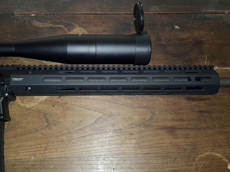

just received my Troy MLOK battle rails HP for my new 18" and 20" builds… since im from overseas, it costed me some good money to have them imported, and have them imported quickly.
ok straight to the point… GOD DAMN!! thanks Troy for polluting the market with products different from what your photo shows, because the rails i was supposed to receive (as seen in the store photos)
were the ones with QD attachments slots (in between the two mounting screws) rails like the one i received ARE NOT EVEN OFFERED ON THEIR STORE/ANYWHERE ONLINE (if you check mlok battle rail for 308 you not gonna find a store showing
one with no qd slots) so what the hell is wrong with them? but thats ok… the rail do look good and i can go past the qd slot… i wasnt intending to use it anyway except that it was looking better :smiley:
but thats not over, because the pain in the a** comes while installing barrels, since on both rails the barrel nut teeth wont index with the gastube hole in the receiver at any of the given torque, had to go around 100 ft/pounds to have it indexed,
while on the other i just had to grind off a teeth because it wont index even at 110 foot pounds… ( know i might have used some shims)

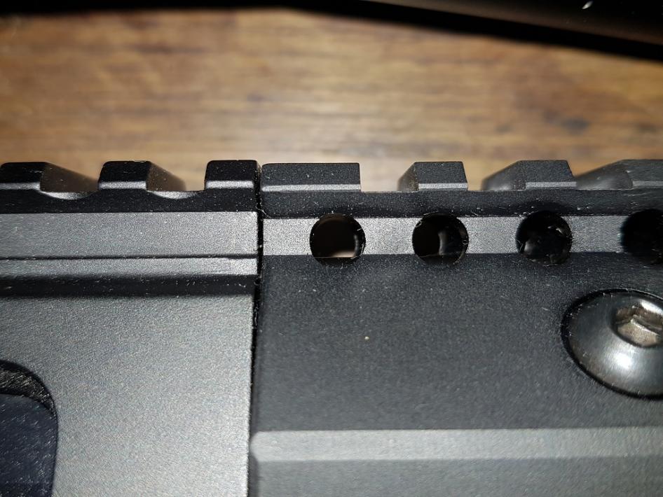

and nope, is not over yet, because once installed the rail is even shorter than the receiver height!!! LIKE WHAT THE FOK? these were advertised as
High Profile rails (infact there are no low profile battle rails for the 308) but as far as i know the low profile should be quite a little lower than that and not just half millimeter. First i had issues with one of the Aero lowers, now the rails… damn lol
Good job Troy, is that what you get when you decide to go with premium Troy instead of UTG because you think UTG is cheap? am i doing something wrong installing the rail?! is 100 /110 foot pounds too much for a 308 upper? i wouldnt be
surprised to loose some fingers next

I didn’t realize Troy offers 308 Rails. I certainly haven’t ready here of anybody using them. My personal use of their products doesn’t extend beyond their folding back up iron sights. It is indeed odd that you received what doesn’t seem to exist, and that leads me to initially wonder if they are counterfeit. You bought them directly from Troy?
I’m satisfied with Aero’s handguards (standard and Enhanced) that I’ve used for a couple of Aero upper builds I’ve done.
Needing to torque them to 100 ft lbs isn’t a situation that I would accept. If 30 ft pounds is on one side of a tooth and 80 doesn’t line up with the next gap, I’d either shim it or call the manufacturer…which in your case isn’t a simple endeavor.
