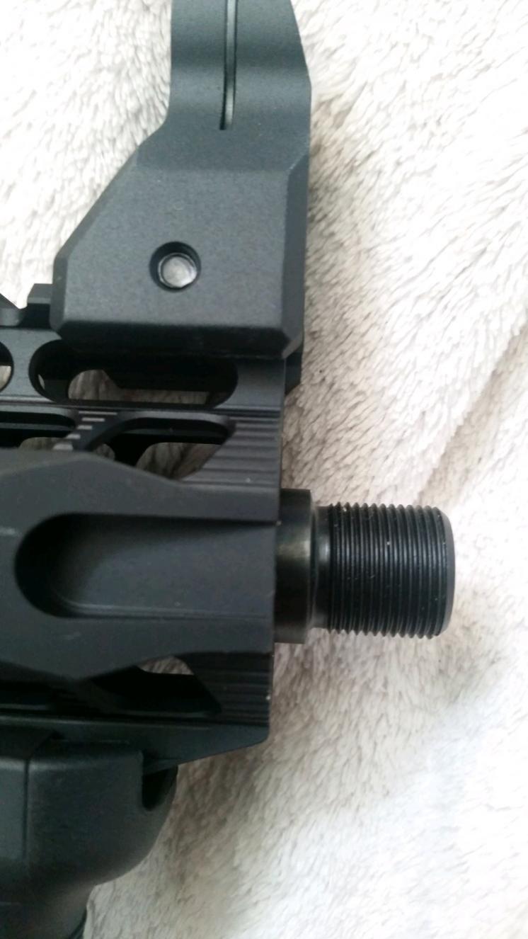

Just some info on my upper. Ordered a 9" bbl, I’ve been told the 8 7/8’s is acceptable. I wanted this build to be small and form factor which it is. I did not go the “rail longer than the barrel” option because I wanted a slimmer rail and I already have a 5.56 upper that’s built with a fat rail on it.
barrel length measurements:
8 7/8’s over all barrel length
8 1/4 from the barrel face to the end of the bbl (non-threaded)
8 3/16’s Rail
1/4 from the rail to the end of the barrel (non-threaded)
1" between the rail and the end of the barrel
7/8’s of threaded barrel
1/8 of barrel between the rail and the start of the threads
Pictures because we all like pictures.
