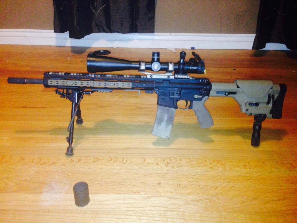

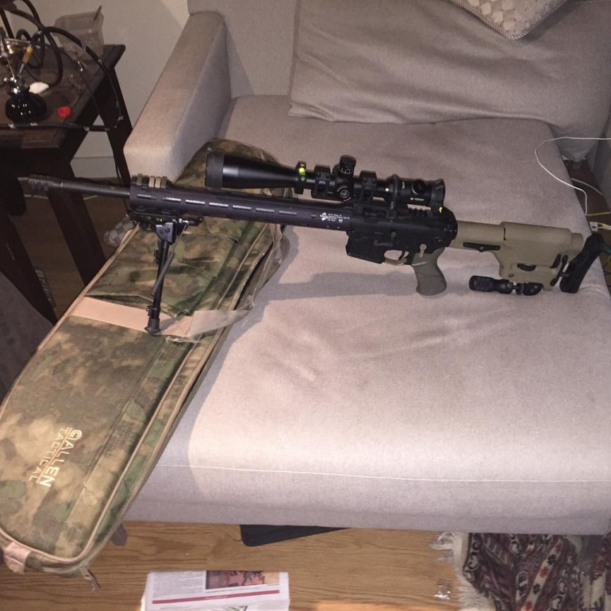

Here are a few photos of my precision SPR in two different configs. The lower is the same. Top Photo is my new 6.5 Grendel 20" barrel with ALG EMR Rail. The Second is my .223 Wylde 18" in a Midwest Industries rail (Keymod) both have forged Aero Uppers. the 6.5 rocking my Vortex Viper PST 6-24 in an ADM Recon-X (my Bobro arrives tomorrow… cant wait!) and the 223 is the same scope mounted in a Warne RAMP mount (Looks super cool but I dont recommend it, sits too low and does not have sufficient cantilever).
A final word about mounts. I suggested the Bobro because it has the best return to zero functionality and is compatible with different upper without making adjustments. LaRue and ADM also make great mounts. If you don’t need QD, ie plan on mount the scope and leaving it, I would go with a LaRue, call them up, they will take $50 off for regular (non-QD attaching mechanism). Any mount you buy I suggest getting the extended version with the most cantilever. Even if you don’t think you will need it you can alway place the mount further back on the receiver.
