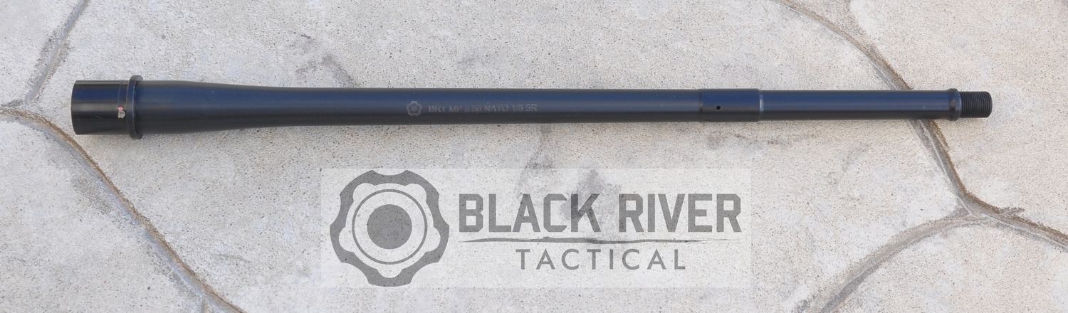

Our BRT OPTIMUM Light barrel may fit your needs nicely.
It is 16" but is comparable to the 14.5" in handiness due to the continuous taper profile and .625 gas block.
The EXT gas length and port sizing allow it to work well with a wide range of ammo and it takes a suppressor well.
For techies, the gas system parameters are similar to a 14.5" mid length.
