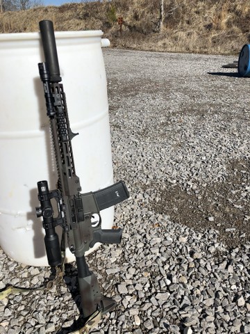

This is a Noveske 13.7 middy barrel build. Currently running an A5H2. Nice and smooth. No issues. Will be testing it with a Saker 556 can later this week. Muzzle device is a Dead Air three prong flash hider, which bring the overall length to just over 16" (pictured with a Dead Air pyro mounted of course)
Nice! I was wondering if the Pyro would work with the MK8.
my gun ran flawlessly until I added a suppressor. Curious to see what results you get with the A5 setup. also what ammo will you be shooting?
Running Federal XM193 for this test run.

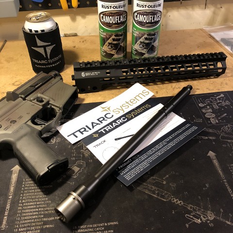

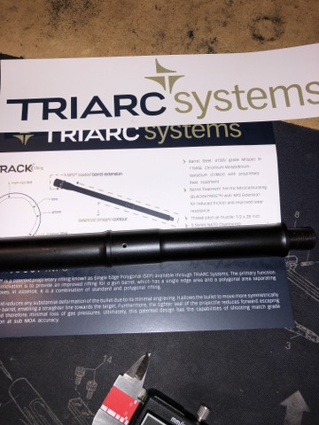

I received the Triarc 13.7" Track barrel today. Won’t be able to shoot it for a few days, but I wanted to post a bit of info for you guys now that I have it in hand.

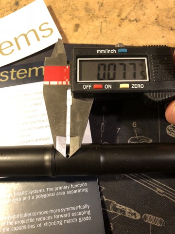

It measures exactly 13.75. Trying to be as accurate as possible with calipers (no pin gauges on hand) the port appears to be roughly .077.
In regards to the barrel length. For those considering pinning a Dead Air flash hider, it looks like a spacer would be needed to get to 16.1. 13.75 + 2.70 = 16.45, subtract .60 (right?) for the threads and that puts you at 15.85.

I emailed Triarc about port size and they told me it was a .073". Regardless of that i’m curious how it turns out for you. I’m using the same rail, suppressor, buffer setup, and the Bootleg bolt carrier. So I will be following this closely. Thanks everyone for the help so far.
