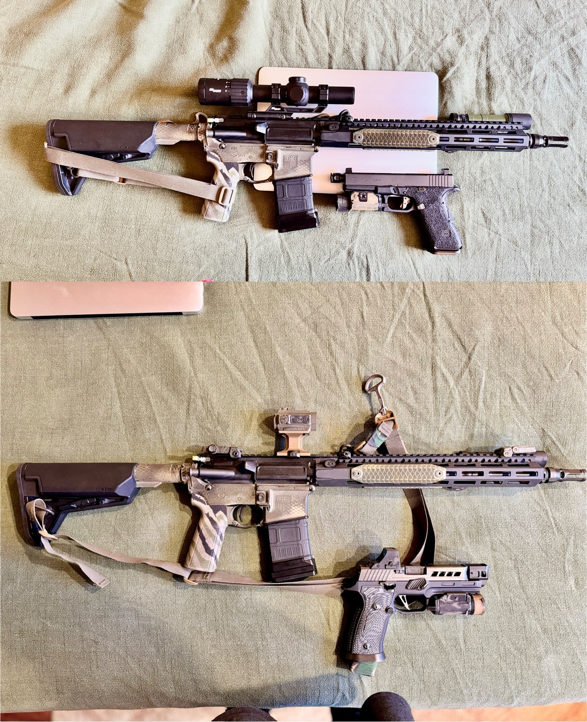

Figured I’d share my experience. I just recently put together a complete upper
13.9 Rosco K9 midlength barrel. BCM receiver/MCMR-13 rail. Microbest bcg, carbine buffer, tubbs spring 4oz buffer.

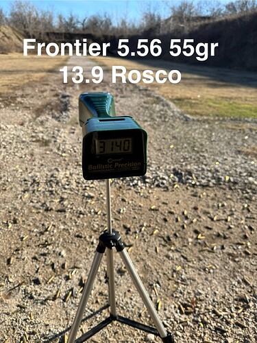

Chrono data was with 5.56 55gr Frontier. (This stuff is fast)

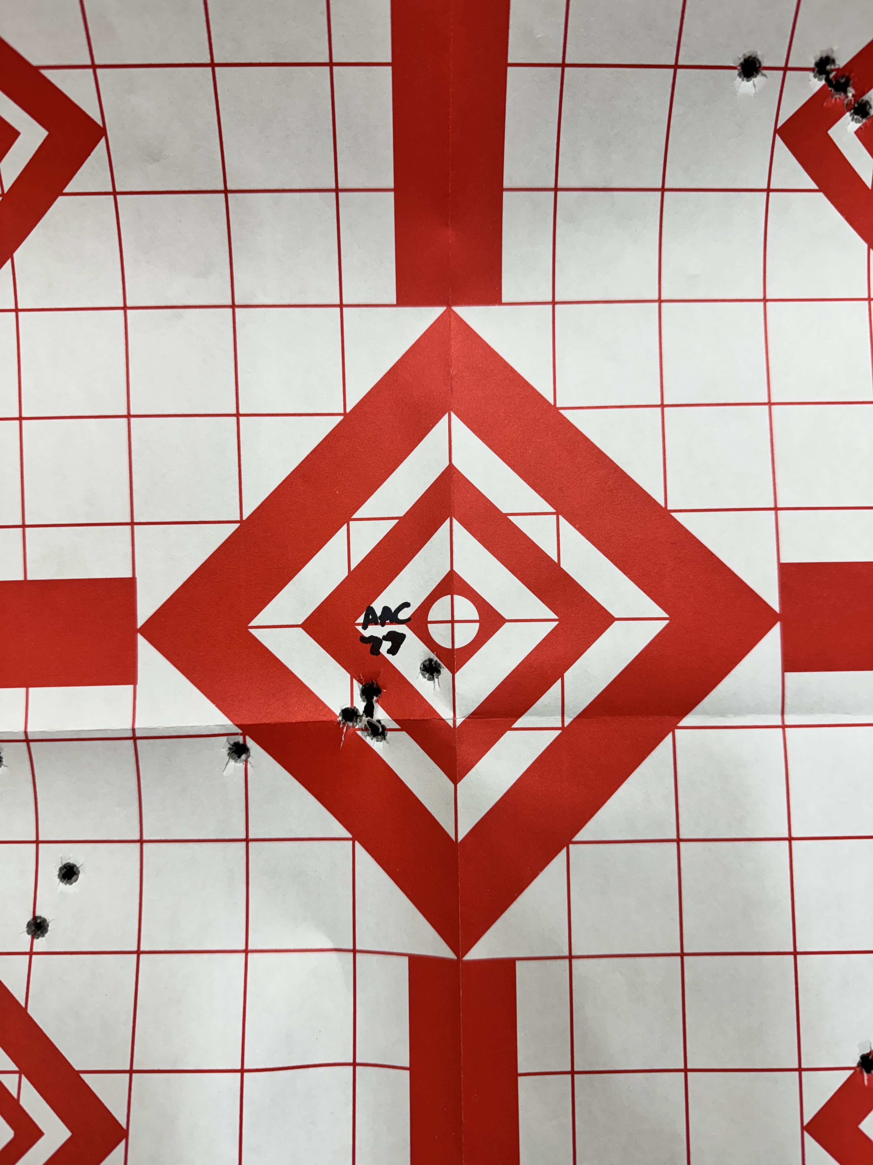

Groups were shot using Sig MSR 1-6 with 5.56 77gr AAC, .223 69gr OTM Freedom remans, dirty 223. 55gr Frontier I found leftover on the table at the range.

3140 is in the danger zone.
No but it was very close. I had to pull the rail back off when I went to install the FH because I could not get my wrench on the Nox once I got close to the end of the threads. I think the lengths matched up perfectly for me. I don’t have a suppressor so unable to 100% verify that.
What do you mean by that? I was under impression we wanted to see 3k-3200fps out of 55s??
Out of a 20" rifle, but not a shorter barrel.
Where’s the sweet spot for 55gr out of a 13.9?
I don’t know that. I’d just be guessing. 2950-3000?
Hornady Frontier is known for sketch pressures. I’ve chronoed a bunch of the 68gr, and every once in a while there’s an outlier that’s like 200fps higher than the normal max range of that loading. Like, faster than M855, which I normally shoot as a constant on a chrono day.
The 55gr has been blamed on the internet for blowing up guns.
