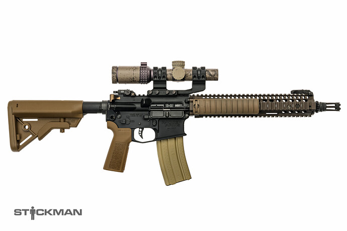

You rang?
Just gotta gloat, don’cha? :stuck_out_tongue: It only came up in context of noting that maximum feasible rail/HG length seems to run around 3/4" less than barrel length unless you want to permanently install a linear comp. (I’m looking at the RHF4 11.5 around a Rosco Bloodline as a “faux” version.)

DOGGONIT, Stick. That’s about the only quad setup I actually “want.” Mostly because I can’t have it.
