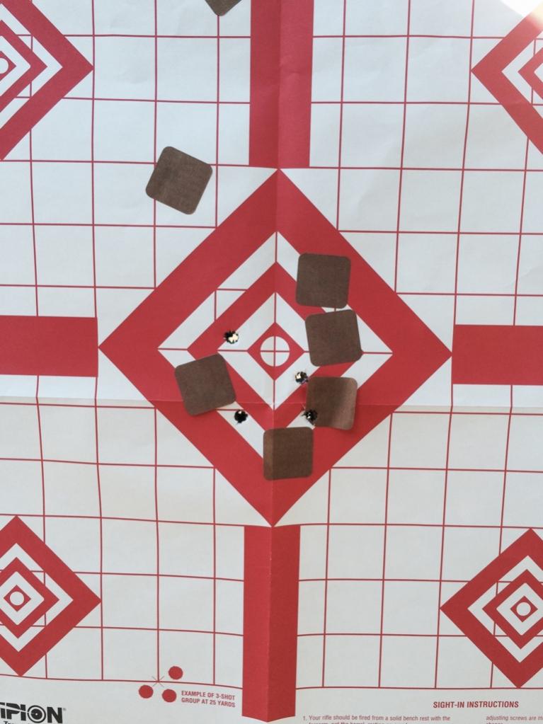

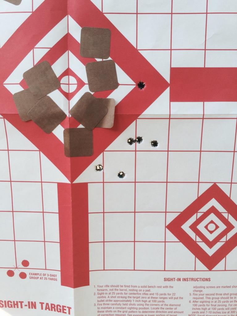

I’d like to see some opinions on this, and also get you guys to check up and make sure I’m not overlooking anything that may be contributing. I can’t seem to get this upper to produce what I consider acceptable groups. Barrel is from a very reputable manufacturer.
10.5 in. 1:7 twist 5.56
VLTOR MUR receiver
LMT enhanced carrier
Wilson bolt
SLR sentry adjustable GB
Wilson TRIM hand guard
I used a vortex PST 4-16 w/ Bobro mount for testing.
This is from 100 yds. Various factory match loads in 69,75,77 grain. All produced similar results. I have checked the barrel nut torque twice and it is perfect. Rifle functions well. I shoot from a solid bench with bags. Two shooters today produced the same results, and the three previous range trips have all produced the same results. 180 rounds through the rifle.
Am I missing anything? Open to all questions and suggestions. Thanks!

Gas tube and carrier key mate perfectly. I removed the muzzle device for testing and there was no appreciable difference. I have used two different scopes, with the same results.
